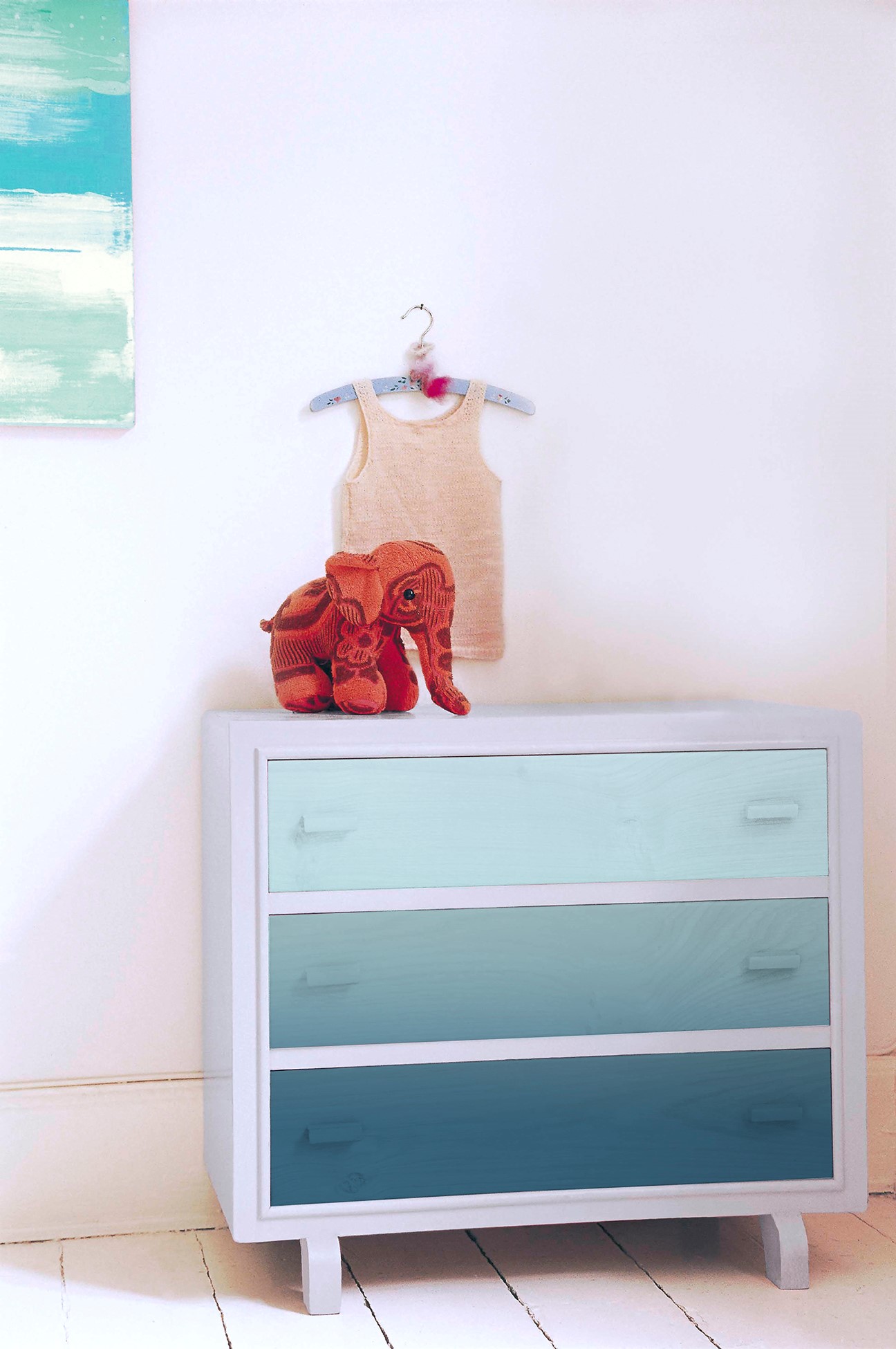

Drawers painted with ‘Dip in the Pool’, ‘Aqua Mosaic’ and ‘Baby Blues’ from the Valspar range (Valspar/PA)
“A coat of undercoat or primer will need to be applied to the piece of furniture first, and once dried, you’re ready to go with your new colour of paint. If painted on plain MDF, you will need to give the furniture a gentle sand after the coat of primer/undercoat, and before applying the paint,” says Cooper.  “The majority of my restoration projects are done using Autentico Chalk Paint which allows me to rejuvenate an old piece and give it a fun and bright coat of paint. It can be used on MDF too, as long as a primer is used first and the Autentico paint is sealed after application. Alternatively, you can use the Autentico Chalk Paint ‘Eggshell’ range without a sealer.”
Baxter adds: “You may find that some paints won’t always stick to surfaces very well, even when the surface been sanded down and primed. As a quick tip, acrylic paint is best in these scenarios. As it’s made of acrylic, this paint sticks far better to a whole host of materials, including plastic, glossy and shiny MDF surfaces. A quick varnish after painting will also stop any paint coming off afterwards.”

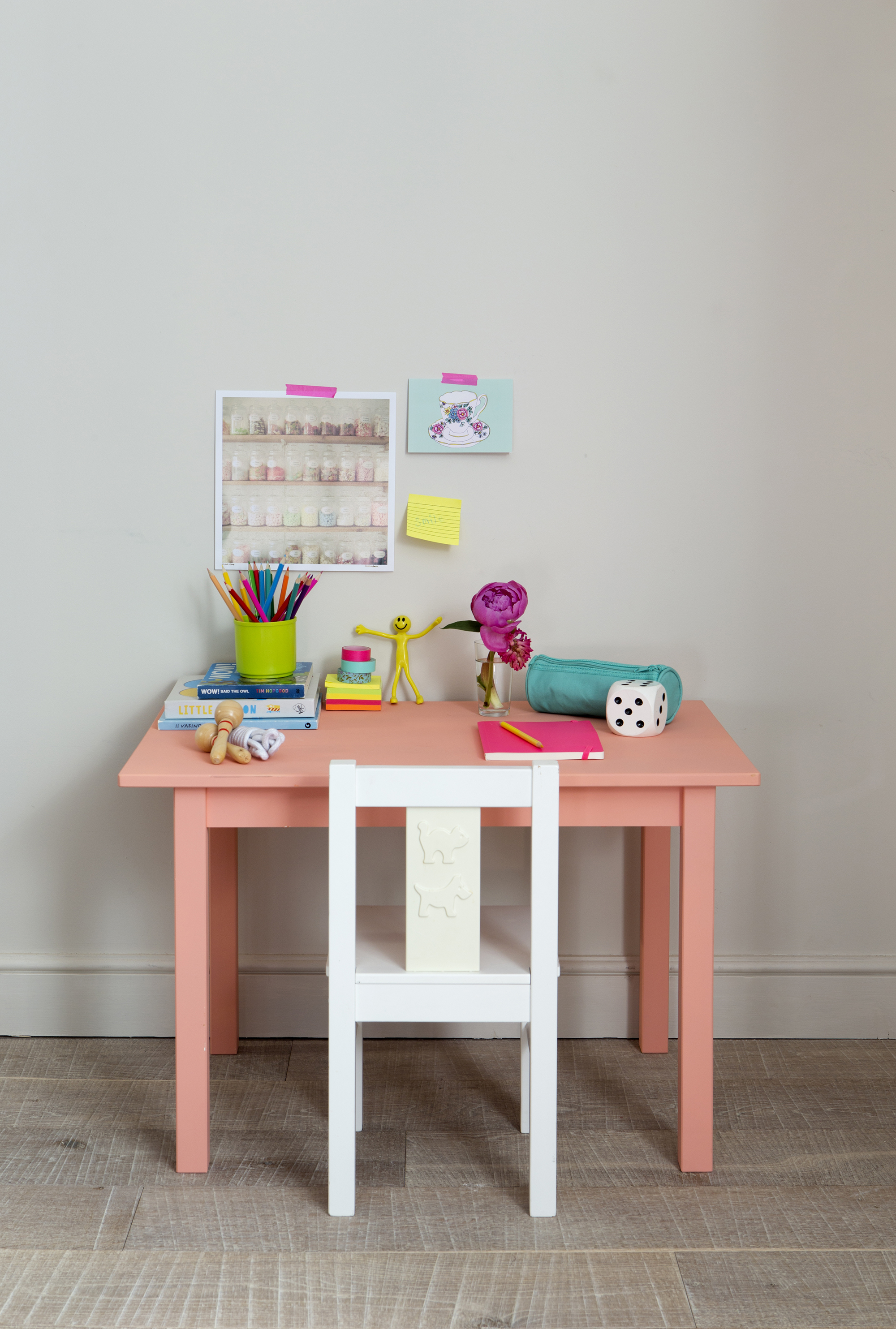

Valspar’s ‘Eraser Pink’ breathes new life into a child’s desk (Valspar/PA)
