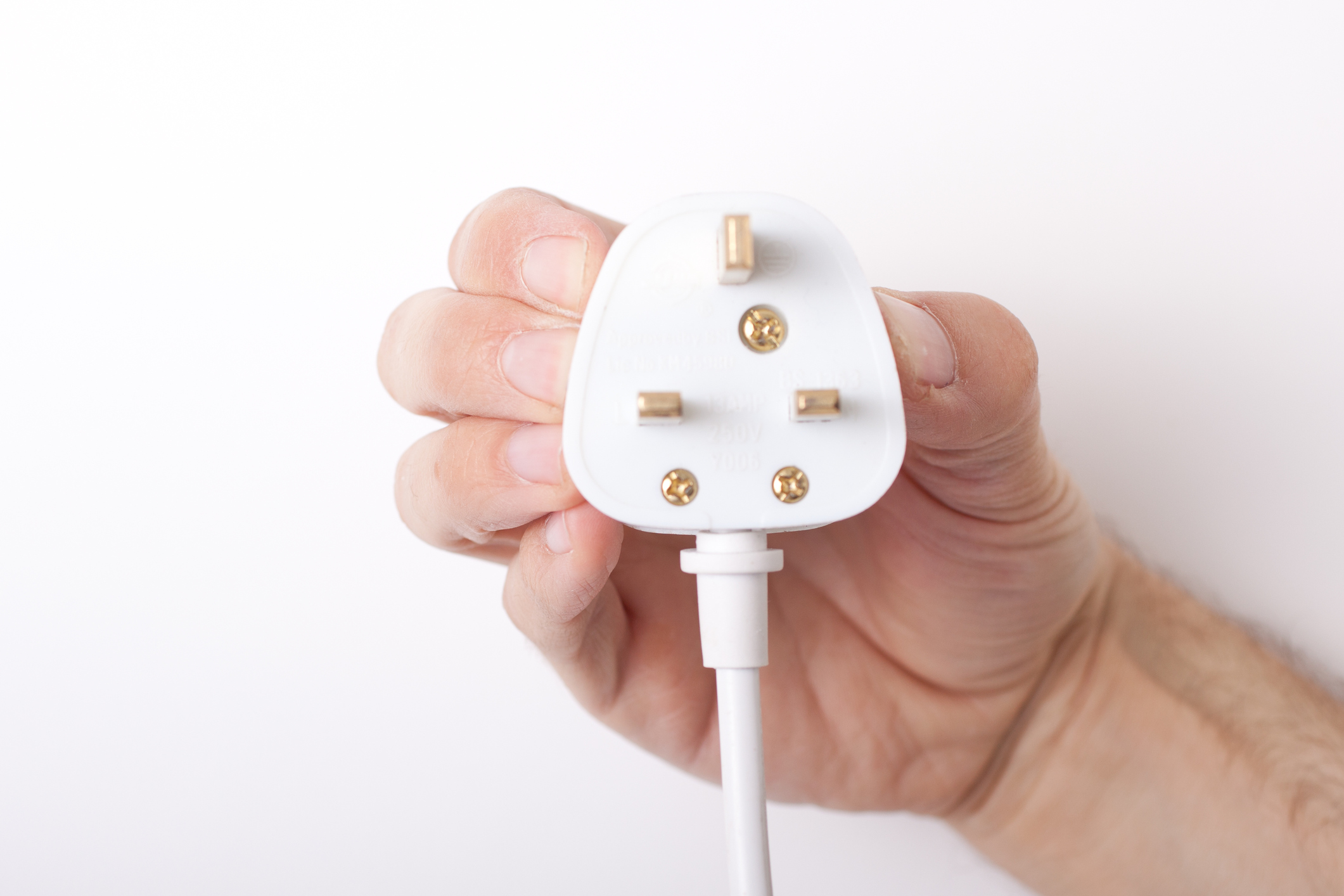

Male hand holding an electrical plug
Ta-da! (Thinkstock/PA)
