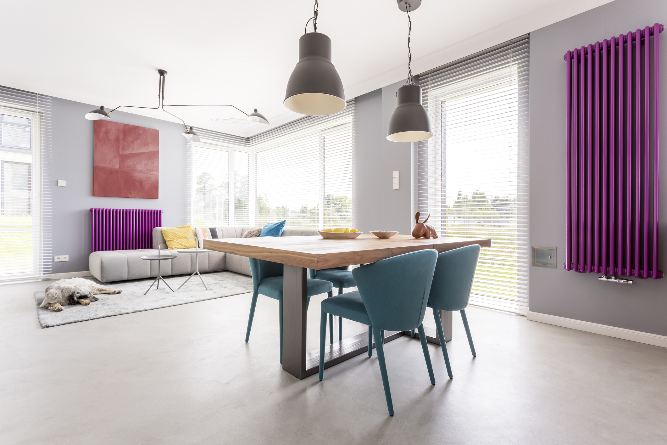

Trendy interior of dining area and open living room with big windows, artwork and colorful accessories
Turn up some style heat (Thinkstock/PA)
