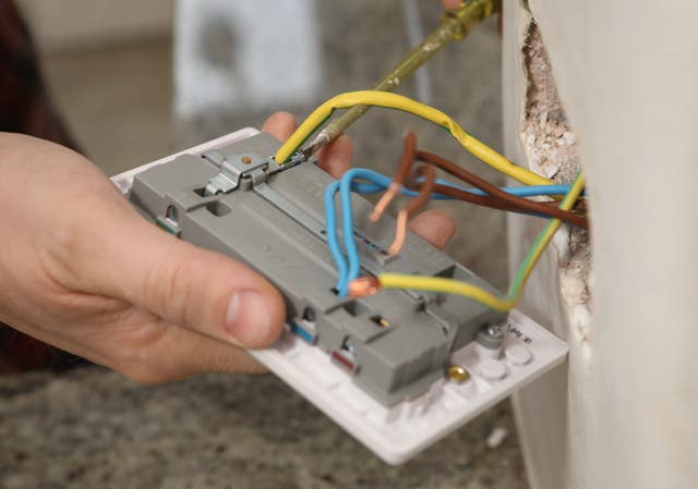

2. Out with the old
Richard Burr fitting a USB plug into a wall
(Philip Toscano/PA)
You’ll need a small, flat-headed screwdriver for this. On the front of your existing socket, you’ll see two screws – one at each side. These attach your socket to the box inside the wall. Carefully unscrew both of these and gently pull the socket forward. You’ll need enough slack in the wires behind to be able to completely flip the socket down so that the back surface is accessible (if you can’t, stop here, screw everything back and get a professional to do the job).
[Read more: 5 tips for making interior walls look better]
If your wiring is pre-2004, the wires you’ll find inside will be red, black, and a green and yellow striped one. If your wiring is after 2004, they will be brown, blue, and a green and yellow striped one. Red and brown are live, indicated by an ‘L’ on your socket, black and blue are neutral, indicated by an ‘N’, and the green and yellow wires are earth, indicated either by an ‘E’ or by three vertical lines. Using your small screwdriver undo the connections for these wires and take off the old socket.

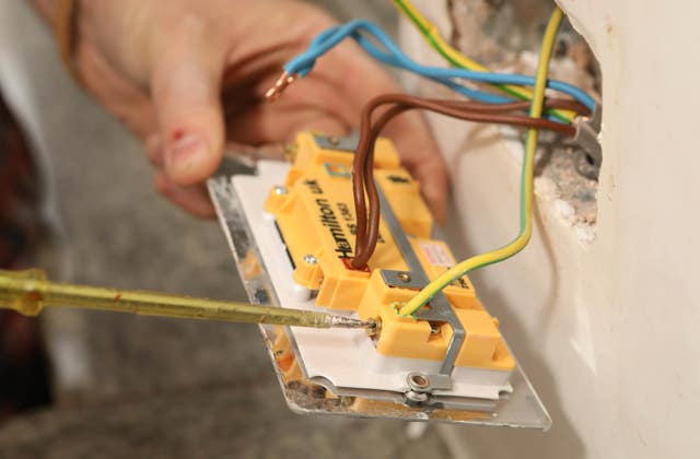

3. In with the new
Richard Burr removing an old socket before fitting a USB plug into a wall
(Philip Toscano/PA)
Unpack your brand new double socket. The back will most likely be different to your old socket, but even if it’s similar, be sure to note which are the live, earth and neutral connectors – it is vitally important that you wire the new socket correctly.
The exposed copper ends of your wiring need to be cut off, as they will have been weakened by tightening into the old socket. Use a side cutter to do this – available on Amazon for around £6, if you don’t already have one. Expose about 5mm of copper on each wire by stripping the coloured casing using your side cutters. Be careful here – you only want to cut through the plastic sheathing – NOT the wire inside.
Before you make the final connection, use your small screwdriver to make sure the terminal screws are fully open. Push the wire(s) into the corresponding terminal until none of the copper wire is exposed, and tighten up with your screwdriver. These need to be firmly fixed but be careful – if you tighten too much, you can shear through your copper wire. Once all your wires are connected, have one last check – remember brown or red are live, blue or black are neutral and green and yellow stripes are earth.
Next, push the new socket into place, being careful not to trap any of the wires between the socket and the socket box. Either use the old screws that you took out initially, or the screws provided with your new socket (they are usually found on the back surface of the socket, to screw the socket front back in place). If you have a small spirit level, you can use that to check everything is straight, but once again, be careful not to over tighten your screws – you don’t want to crack the plastic casing of your new socket at the final hurdle.

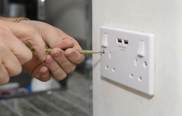

4. Turn it back on
(Philip Toscano/PA)
Go back to your consumer unit and flick your fuse or fuses back on. It should stay on – if it flicks back off immediately, go back and check your connections into the socket.
Once the power is back on, go and check the socket works properly with your socket tester (if you try to test by plugging in a lamp, you may miss some faults, even if the lamp turns on). And that’s it! Charge up devices whenever you like, without looking for plug adaptors, and then get all evangelical with your mates about how useful they are!
