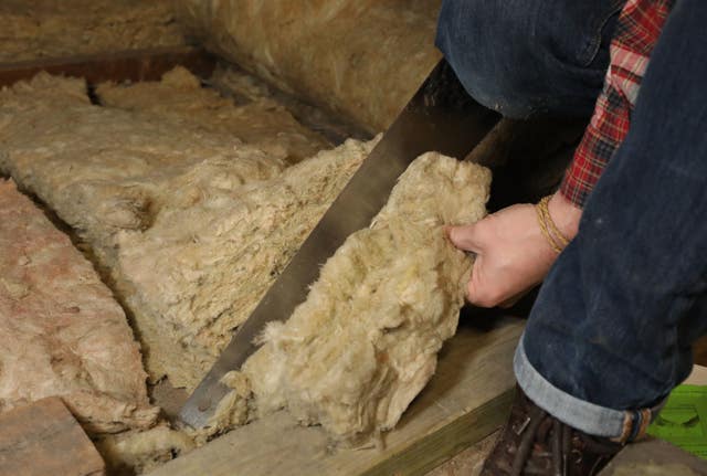

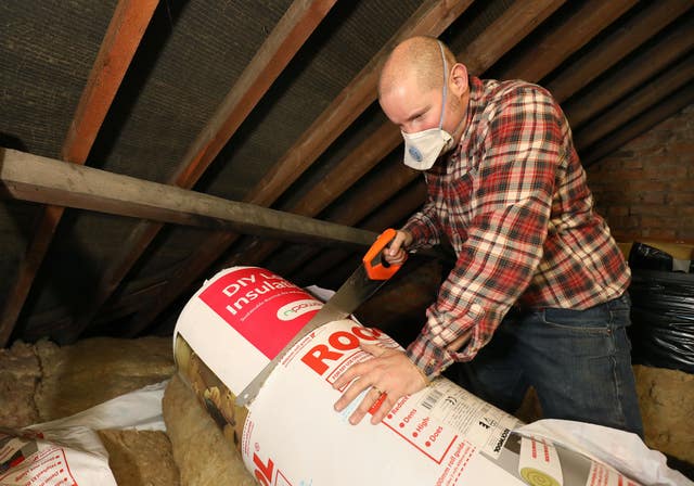

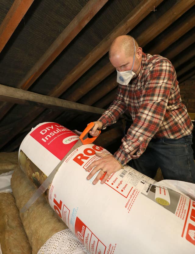

When you take the outer packaging off the rolls of insulation, you’ll find some pre-sliced perforations cut into them – these usually correspond with the widths of your joists, so you can lay the bottom layer of insulation between them. Use your saw to cut the insulation while it’s still rolled up and compressed.

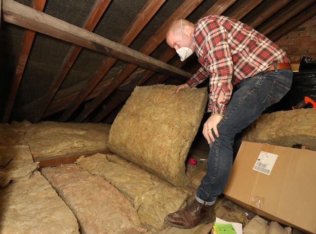

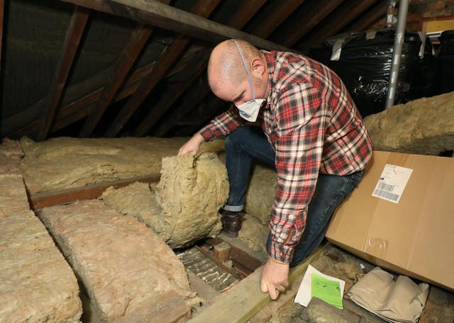

Measure the length of your loft allowing for 100mm of gap at the eaves (the bit where the roof touches the walls) for air flow, and cut lengths of insulation accordingly. Roll these into place starting from the space furthest from your loft hatch.
Once you have finished laying the bottom layer of insulation, you will need to lay the top. Lay this across the joists (rather than in line with them) so the top layer is perpendicular to the bottom layer, once again leaving a 100mm gap at the eaves to allow for air flow. If you want to use your loft for storage, build wooden staging as described above.
