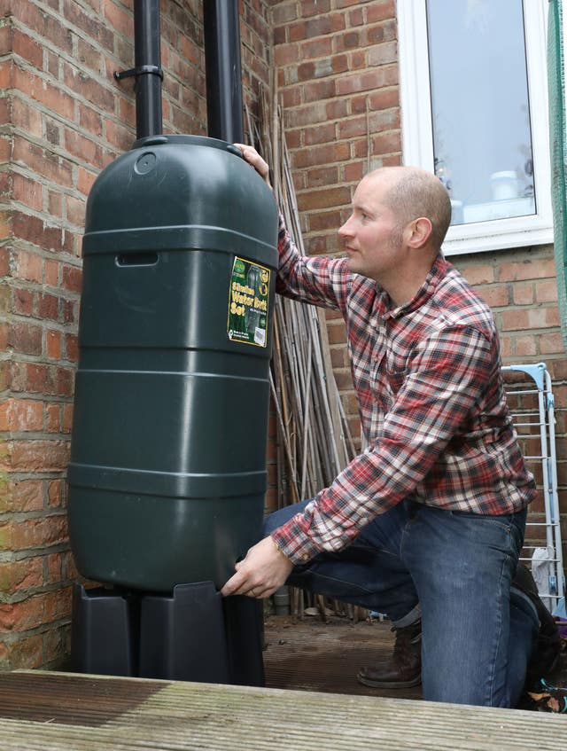

Be sure to raise your butt off the ground
Depending on how much space you have, you can buy water butts that hold various volumes of water, from 25 litres up to over 500 litres. Slim ones are easy to come by and will fit discreetly down a side passage. Most butts will be in the 100-120 litre range and are perfectly adequate. But no matter what sort you get, they need to be mounted on a solid surface and be high enough from the ground to be able to get a watering can or a bucket underneath.
Most water butts have a compatible stand or staging that they come with, otherwise you can easily pick one up. Remember, a litre of water weighs 1kg, so depending on what capacity you buy, your stand will need to potentially carry quite a lot of weight. If you are situating your water butt on an already solid surface, you can place the staging directly onto this. If you are putting the water butt on something less than solid (a flower bed, for example) you’ll need to lay a paving slab nice and level.

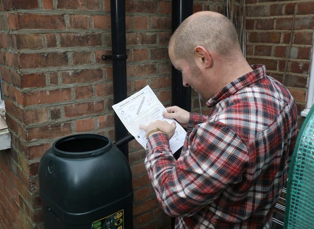

Fitting the diverter
Once your staging or stand is set, you can plonk (technical term) the water butt on top of it and fit the piping. Your butt will come with a tap fitting, which goes at the bottom and will be fairly easy to screw into place – make sure you tighten it up well, or you’ll have a slow drip that will empty the butt annoyingly quickly.
Now you can fit the diverter. This is the piece of equipment that takes water from the downpipe and channels it into the butt. It’s very important that the diverter is attached to the downpipe below the top level of your water butt, or once the butt is full with rain, the butt will overflow, rather than allowing the water to just continue down the downpipe.

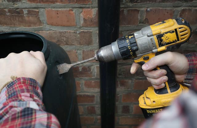

Using your spirit level, mark the top of the rim of your water butt against the downpipe. Measure 3cm down from here and cut through your downpipe with a hack saw (try to make the cut as level as possible). Pull the two ends of downpipe apart and insert the diverter, then push them back into place.
Measure 5cm down from your cut in the downpipe and use the spirit level to mark this on the water butt – this is the height you’ll need to drill the hole in the butt to connect the other end of the diverter. It should say on the diverter packet what diameter drill bit to use, but they are usually around 25mm.
